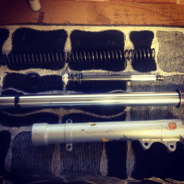

Sunday arvo fun.. got the forks out, just need to fab up a seal driver and put it all back.
Was a little weird only finding one spring in the front end I tell you. I've done a bit with enduro suspension over the years but wow.. talk about different!

Are those forks Paioli 38's with spring preload adjustment on one leg and dampening on the other? The internals look exactly the same as the ones that came with my Sherco.
They are very easy forks to work on, especially compared with the cartridge forks found on most motocross and enduro bikes.

From what I can tell they are the same forks in both bikes, maybe some adjusted valving across the years/makes.
One thing that has me stumped is the spring side when fully extended is 30mm shorter than the other. This was the case before I pulled them down, at first I thought nothing of it. Now I've put them back together I'm thinking there is somthing not quite right?? Trawling the internet looking for a proper exploded diagram of these without much luck.
